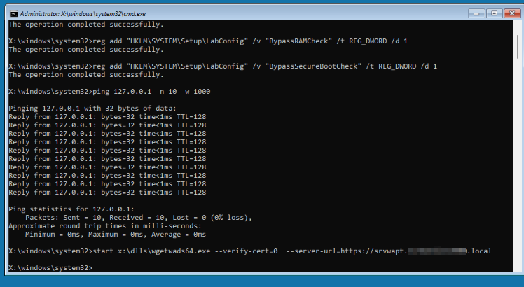

I can no longer get WADS to work.
After updating WAPT, I updated winpe with the new minimal wads package.
Despite this, I am experiencing the following malfunction:
- The PC boots via PXE and we reach the point where we name the PC
- It appears correctly in WAPT and I can validate the configuration as well as the DJOIN; I launch the deployment
- On the PC, I press "2" to launch and I end up with this:

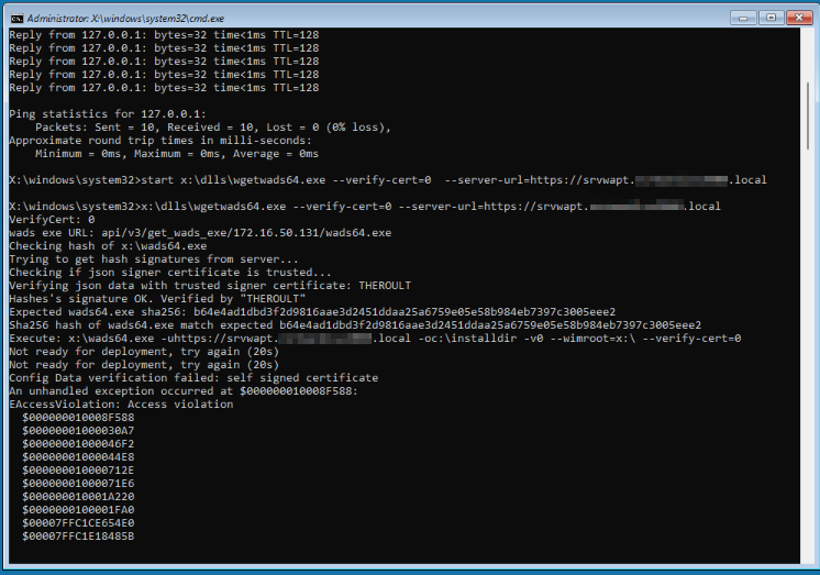

If I manually restart wgetwads64, I get this (and it loops indefinitely):

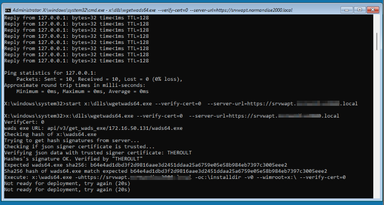

If I manually rerun wgetwads64 BUT WITHOUT the double space before --server-url, I get this:

The strange config data error indicates "config data verification failed,"
which suggests that the configuration (XML) is incorrectly signed or not signed by a recognized key.
Do you have multiple keys?
If not, edit the XML configuration (add just a space, for example); this will re-sign it.

Result:
After re-signing the configuration file, I restarted the installation, and this time it was the ISO that needed re-signing.
So I downloaded it and re-uploaded it, and this time, finally, it worked.
