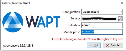

I just updated my server (Windows Server 2019) from version 1.8.2 to 2.2. The update appears to have gone perfectly, but afterwards I can't connect to the console; I get the error message "Login error: You don't have the rights to log here"
And everything seems fine with the configuration file, I can't find a solution...
Thanks in advance !

we had an issue with the previous version.
I've just fixed it in a nightly version here: https://wapt.tranquil.it/wapt/nightly/w ... 5-3fd94bd1
Could you please try again?

Hi Simon,
thanks for your reply, everything seems OK now!
The machines are starting to show up in the console, all that's left is to update the agents and get used to the new console!
