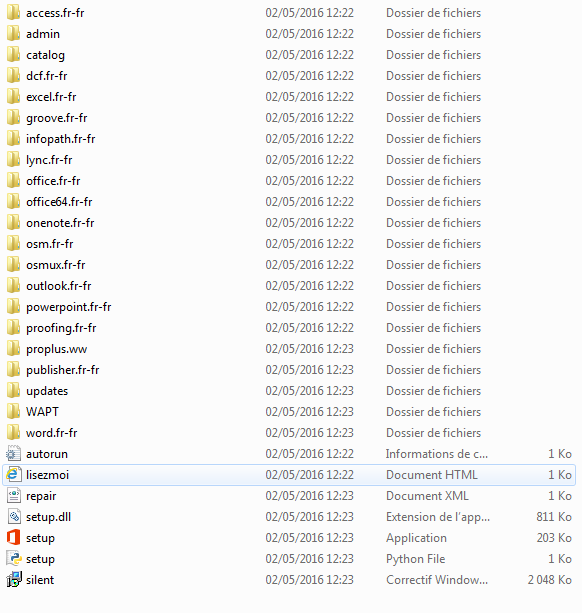

I confirm that the setup.exe and silent.msp files are present with the correct names (I tried replacing "setup.exe" with "setup" in the .py file). I still get the same error with the --direct option.
Problem testing an MS Office 2010 package

Did you copy all the other files and not just setup.exe and silent.msp,
as shown in the attachment?

Thank you so much, the package works perfectly now, that was all it was
