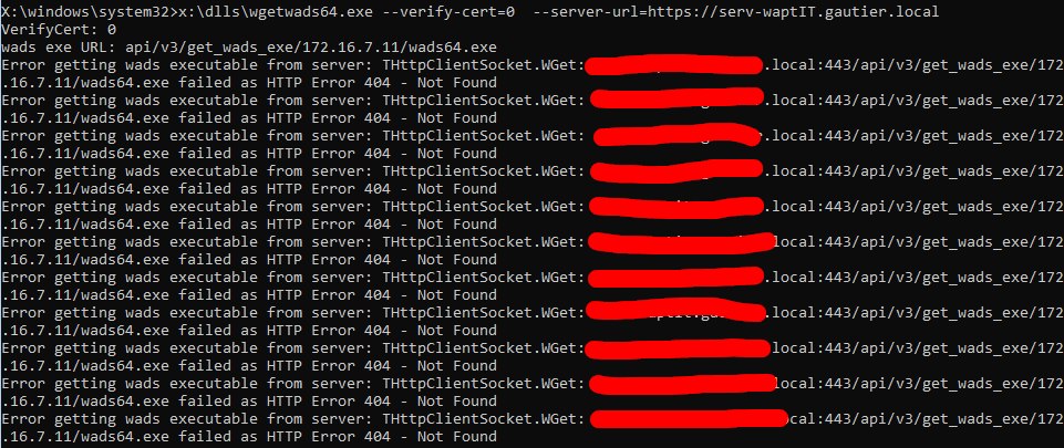

It seems the error is due to the wads.exe executable not being available.
How can I resolve this issue?
Anthony
Anthony
- Attachments
- error wads64.exe.png (56.88 KiB) Viewed 8472 times

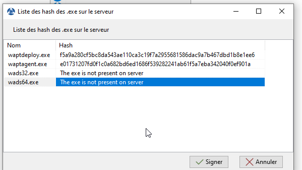

Looking at your documentation, I see that the wads64 executable is not present on the server.
How can I reinstall it, please?
Thank you in advance.
- Attachments
- wads.64.png (11.97 KB) Viewed 8468 times

After analyzing the situation, I realized I had deleted the entire wads directory (rm /var/www/wads/*) instead of deleting the ISO files stored within wads (rm /var/www/wads/iso/*). After restoring
my VM using Veeams, the wads64.exe file reappeared.
However, without restoring the VM, what is the procedure for reinstalling the files I accidentally deleted?
Do I need to update the version and then update post.conf, or is there another solution?

Hello admgautier,
yes, updating (or forcing a reinstallation of the same package version) would have done the trick. I'm marking the topic as resolved.
Regards,
