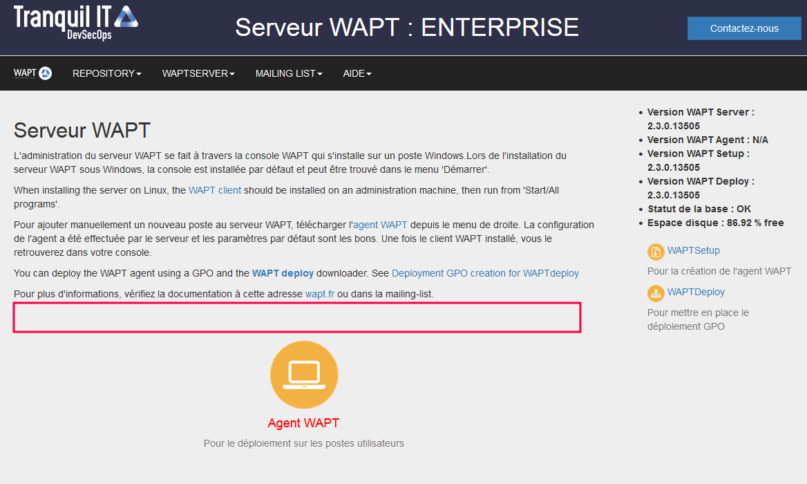

Hello everyone,
Since I've been tinkering quite a bit with my test instance of the server, I've decided to start from scratch (uninstalling the agents, the server, postgresql...) and above all the idea was to start directly from version 2.3 and not a 2.2 update.
The installation went smoothly, and now it's time to deploy the agent. I wanted to use the waptdeploy method, but the series of parameters to pass to waptdeploy is no longer available on the Wapt server portal.
However, the documentation is still planned: https://www.wapt.fr/en/doc/wapt-deploy- ... with-a-gpo

you need to generate the agent at least once, i.e., download the WaptSetup to the management machine, configure it, and then generate the agent. The command line for the GPO will then appear.

and explanation: the hash of the WAPT agent is actually in the `waptdeploy` line, so it needs to have been uploaded beforehand for the hash to be calculated.
