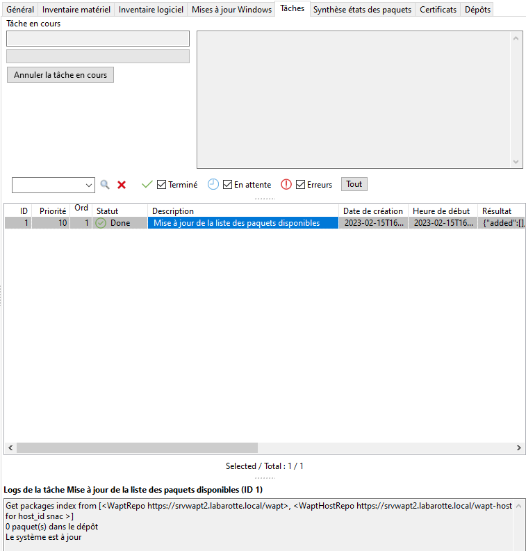

If it helps, in the "Tasks" tab, I see this:
2023-02-15 17_33_18 - Staches.png (22.89 KB) Viewed 10170 times
I hope you find a solution because I am indeed without a working WAPT server and have no idea how to find another one quickly...

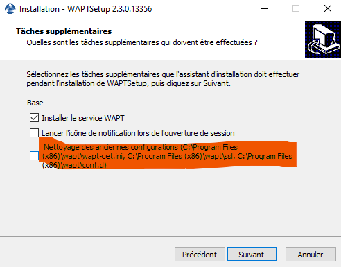

There must be an inconsistency between the certificates used to sign your actions and packages (see personal certificate in console preferences) and those in the C:\Program Files (x86)\wapt\ssl directory of your agents.
Here's what could have caused this inconsistency during console installation:

thank you very much for your reply.
So, I should select this option when reinstalling the console?

no it's the opposite, you need to keep your configuration and therefore leave it unchecked.

Ah, okay, thank you. I thought that was what I had done.
I understand that it might have had some effect on the need to reconfigure the console. However, I don't understand how that explains the final problem, namely the packages not installing.
