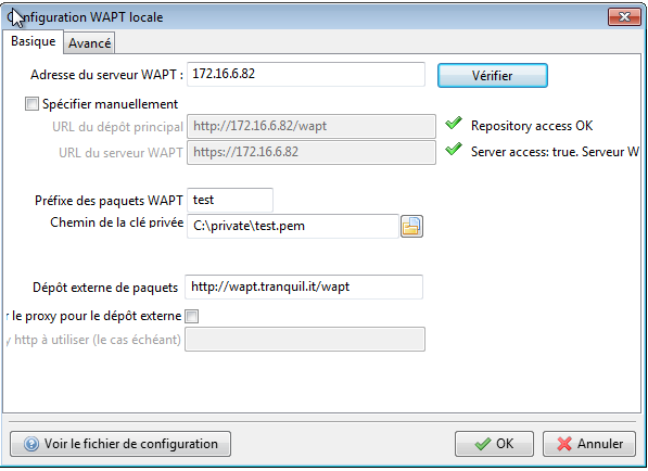

I'm having trouble with my setup. When I try to import packages from the internet or create my WAPT agent, I get the following message: "The private key does not exist."
My infrastructure:
1 Debian 8 server with WAPT (https://dev.tranquil.it/scenari/guide_a ... ebian.html)
1 client workstation with WAPT console: Windows 7 Pro on a domain
1 client workstation: Windows 7 Pro on a domain
1 client workstation: Windows 7 Pro on a non-domain
I followed the procedure described above to the letter, and I do have certificates (PEM and CRT) in my c:\private\ directory.
I specified the path to the private key in the WAPT preferences (see attached image).
Do I need to integrate the private key into the Debian server? I performed the same installation with a WAPT server on Windows without any problems.
Thank you for your help.

Hello again,
While browsing a website https://wiki.lesfourmisduweb.org/index. ... nsole_WAPT,
I read a sentence about DNS:
"Using IP addresses is not recommended (some bugs have been reported)."
In production, I use the fully qualified domain name (wapt.mydomain.fr). It has the advantage of working even if the `nslookup` command for Wapt fails.
So, I reconfigured my console by calling the DNS name, and that resolved my issue. :D I'll test my theory on how to solve the problem with the second prototype this evening.
