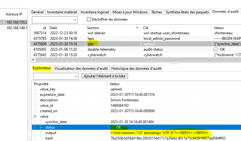

You might see a result in the audit data. If it's not "OK", then in the output you'll see the message returned from GLPIvincent.moisan wrote: ↑January 26, 2023 - 4:18 PM Hello,

I'm getting an error message indicating that the XML file is malformed. (See attached image)

Hi Vincent,
the GLPI export packages might not be named correctly:
* tis-glpi-plugin-export-to-glpi9 -> XML format for Fusion Inventory Agent
* tis-glpi-plugin-export-to-glpi10 -> JSON format for native GLPI Agent.
If you're using GLPI 10, the simplest solution is to use the native JSON format, without installing the Fusion plugin on GLPI, and be careful to use the GLPI Agent URL endpoint and not the Fusion endpoint.

Hello dcardon,
Yes, it works much better now.
