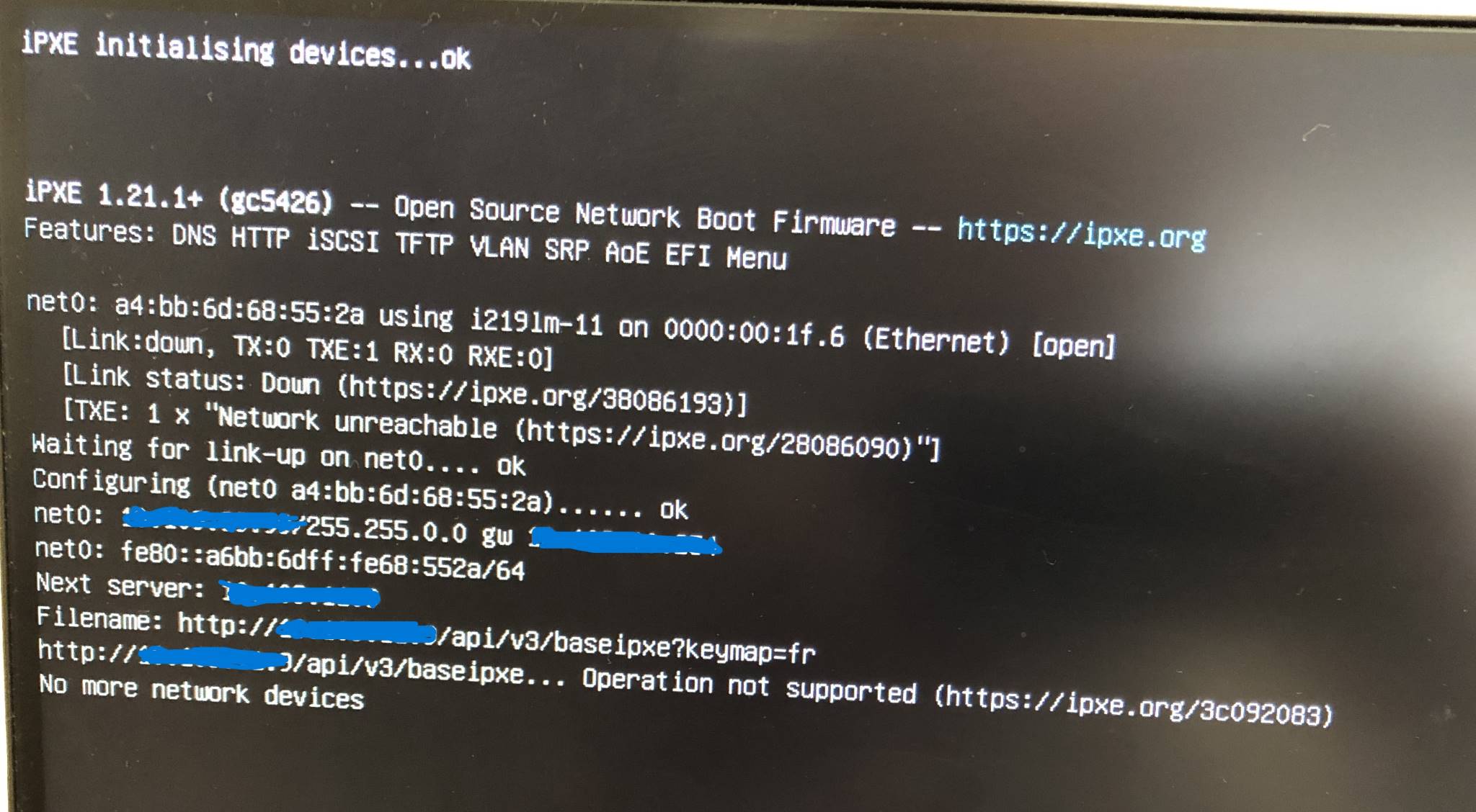

When I start the test machine, it retrieves the necessary information, including its IP address, but then stops, giving me the message that the operation is not supported (see attached image).
The IP addresses are correct.
I don't see what I could have missed in the settings.
Do you have any idea what the problem might be?

if you visit the URL:
Does it work? No redirection to https (viewtopic.php?t=3038) ?
Code: Select all
http://srvwapt.mydomain.lan/api/v3/baseipxe?keymap=fr-

, I saw the thread about HTTPS. I modified the settings in the files to remove HTTPS, but it still doesn't work.
There must still be HTTPS in a file, but I don't know where.
Should I rerun the configuration script without the `force-https` parameter?

Yes, indeed, just restart this and don't skip the nginx reconfiguration
/opt/wapt/waptserver/scripts/postconf.sh
- WAPT Expert
- Messages: 2380
I just got off the phone with a client; it must just be that WADs isn't active.
If you're using Linux, in the POST configuration you need to answer "yes" to the question "enable OS deployment".

After re-executing the script, everything is working correctly.
The OS deployment is successful.
