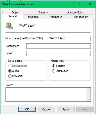

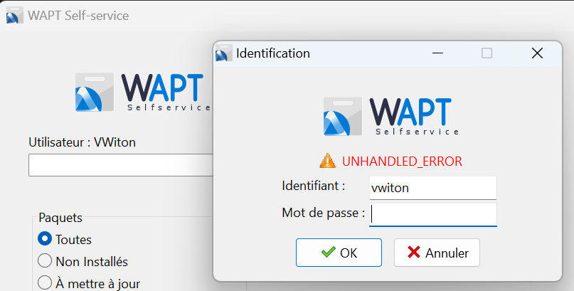

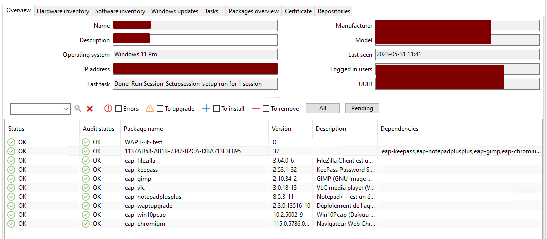

I'm a colleague of anmartin's. We ran more tests this morning and indeed the problem isn't with spaces or underscores.
However, we have groups containing parentheses, and these are what's causing the issue (see attached).
Are you experiencing the same problem on your end?
