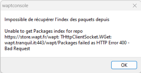

We have recently been getting the following error when we try to "import a package from the Internet" using the console:
Is this widespread or just happening in our area? We don't know how to explain it.

Mikael_S
Messages: 26
Registration: Apr 25, 2023 - 11:57
July 31, 2023 - 09:38
I'm also having the same problem this morning, with the same version of Wapt.

July 31, 2023 - 3:09 PM
it's working again, so I imagine the problem has been resolved.

vcardon
Messages: 278
Registration: Oct 06, 2017 - 10:55 p.m.
Location: Nantes, France
July 31, 2023 - 8:02 PM
There was a problem with the redirection on the TIS side and with the associated certificate. The redirection will be restored, but we'll make it more seamless. Thank you for your vigilance and responsiveness.
