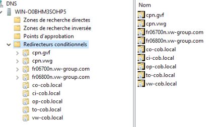

Hello Tranquil IT members
, this is my first post, I hope I'm clear and concise.
Here's my infrastructure:
2 different domains that I want to trust together and 4 domain controllers running Samba.
Domain A:
co-cob.local
co-cob-pdc1: 192.168.1.237
co-cob-pdc2: 192.168.36.209
Domain B:
vw-cob.local
vw-cob-pdc1: 192.168.5.209
vw-cob-pdc2: 192.168.6.209
I modified the smb.conf file to add a forwarder capable of resolving these two domain names on all 4 PDCs.
When I try to trust the vw-cob.local domain on co-cob-pdc1, I get this error message on the last line.

Do you have any idea how to unblock this?
Thank you for your help
