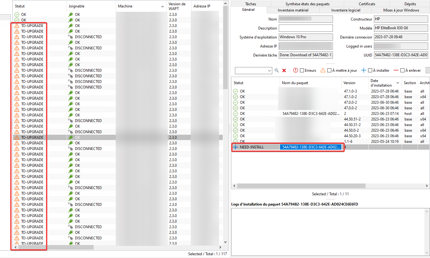

Although the installations are going well on the workstations, they do not switch to OK status because an unknown installation is still in progress.
These pending installations have a different UID name for each of them, and this has been going on for a while.
Do you know why?

Yes, this name corresponds to the BIOS UUID of each machine. It's a machine package containing all the packages necessary for the machine. In the screenshot, we see that version 2 of this package is installed and version 4 is pending. What happens if you install this package?

Indeed, when I force the installation, it turns green.
But what exactly is the purpose of this package?

this is used to verify that all the dependencies within are correctly satisfied.
