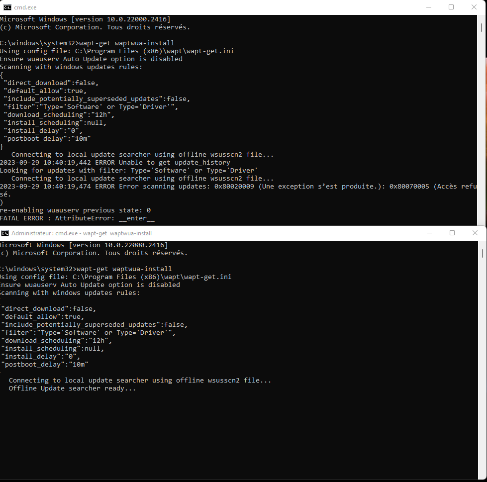

The agents are working correctly, but I'm experiencing some strange issues I didn't have before:
From the console, I can't run the update checks (or anything else); nothing happens
on the old PCs. On the new PCs, if I type `wapt-get waptwua-install` with an admin account in the command prompt, I get an error. If I run it in admin mode, it works... (waptget_waptwuainstall.png). Is this normal?

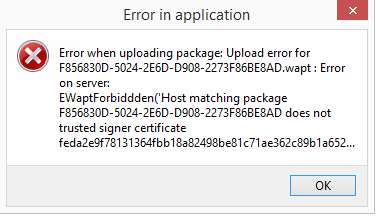

Also, on a new PC, I'd like to install Nginx, so I downloaded the package, but when I try to deploy it, I get an error message. (error_deploy.png)
I checked the logs on the PC and there doesn't seem to be a problem.
I included my wapt-get.ini file and the log in the zip archive.

you have all the symptoms of a certificate error.
Does the certificate you're signing with appear correctly in the machine's certificate tab (on the right)?
