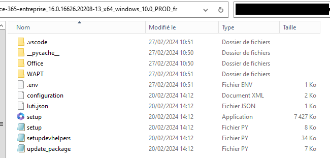

However, I've noticed a problem. My configuration.xml response file isn't being recognized. Have I missed something?
The file is stored on my server in the root directory, near setup.exe.

being a complete beginner, I don't yet understand the concept of a package.
Is it the .wapt file or the directory (where the installation files are stored)?
My configuration file is in the c:\waptdev\microsoft-office-etc... directory.
I must be missing something.

Thanks, so I was right.
However, that doesn't explain why my answer file isn't being recognized.
The package structure is correct. My configuration file is indeed in the root directory and at the same level as setup.exe.
Below is my setup.py file, which I haven't modified. It's the one from the original package.
There's still one line that bothers me:
# TODO "setup.exe /customize configuration.xml if up-to-date" Is there any action I need to take after inserting my file, like a rebuild/repack?

registry_set(HKEY_CURRENT_USER, r"software\policies\microsoft\office\16.0\osm\preventedapplications", "olksolution", 1)
registry_set(HKEY_CURRENT_USER, r"software\policies\microsoft\office\16.0\osm\preventedapplications", "accesssolution", 1)
registry_set(HKEY_CURRENT_USER, r"software\policies\microsoft\office\16.0\osm\preventedapplications", "projectsolution", 1)
registry_set(HKEY_CURRENT_USER, r"software\policies\microsoft\office\16.0\osm\preventedapplications", "publishersolution", 1)
registry_set(HKEY_CURRENT_USER, r"software\policies\microsoft\office\16.0\osm\preventedapplications", "visiosolution", 1)
registry_set(HKEY_CURRENT_USER, r"software\policies\microsoft\office\16.0\osm\preventedapplications", "onenotesolution", 1)
# https://admx.help/?Category=Office2016& ... utionTypes
registry_set(HKEY_CURRENT_USER, r"software\policies\microsoft\office\16.0\osm\preventedsolutiontypes", "documentfiles", 1)
registry_set(HKEY_CURRENT_USER, r"software\policies\microsoft\office\16.0\osm\preventedsolutiontypes", "templatefiles", 1)
registry_set(HKEY_CURRENT_USER, r"software\policies\microsoft\office\16.0\osm\preventedsolutiontypes", "comaddins", 1)
registry_set(HKEY_CURRENT_USER, r"software\policies\microsoft\office\16.0\osm\preventedsolutiontypes", "appaddins", 1)
registry_set(HKEY_CURRENT_USER, r"software\policies\microsoft\office\16.0\osm\preventedsolutiontypes", "agave", 1)
# https://admx.help/?Category=Office2016& ... bleLogging
# registry_set(HKEY_CURRENT_USER, r"software\policies\microsoft\office\16.0\osm", "enablelogging", 0)
registry_set(HKEY_CURRENT_USER, r"software\policies\microsoft\office\16.0\osm", "enableupload", 0)
registry_set(HKEY_CURRENT_USER, r"software\policies\microsoft\office\16.0\osm", "enablefileobfuscation", 1)
# # https://admx.help/?Category=Office2016& ... entoptions
# registry_set(HKEY_CURRENT_USER, r"software\policies\microsoft\office\16.0\common\internet", "useonlinecontent", 0)
# # https://admx.help/?Category=Office2016& ... velOptions
# registry_set(HKEY_CURRENT_USER, r"software\policies\microsoft\office\16.0\common\internet", "serviceleveloptions", 0)
def uninstall_other_office_edition(edition_uninstallkey):
# Initializing variables
silent_uninstall_file_path = makepath(tempfile.gettempdir(), "remove_other_office.xml")
uninstall_configuration_xml_content = r"""
<Remove All="TRUE">
</Remove>
<Display Level="none" CompletionNotice="No" SuppressModal="Yes" AcceptEula="Yes" />
<Setting Id="SETUP_REBOOT" Value="Never" />
<Setting Id="REBOOT" Value="ReallySuppress"/>
</Configuration>
# Modify XML
with open(silent_uninstall_file_path, "w") as xml_file:
xml_file.write(uninstall_configuration_xml_content)
killalltasks(control.get_impacted_process_list())
# Uninstalling Office if needed
for to_uninstall in installed_softwares():
if ("OfficeClickToRun.exe" in to_uninstall["uninstall_string"]) and not (edition_uninstallkey in to_uninstall["key"]):
print("Removing: %s (%s)" % (to_uninstall["name"], to_uninstall["version"]))
app_uninstall_cmd = to_uninstall["uninstall_string"] + " DisplayLevel=False"
run(app_uninstall_cmd)
wait_uninstallkey_absent(to_uninstall["key"])
def uninstall_mso2016_if_needed(uninstallkey):
silent_uninstall_file_path = makepath(tempfile.gettempdir(), "remove_o2016.xml")
<Remove All="TRUE">
</Remove>
</Configuration>
# Modify XML
for to_uninstall in installed_softwares(uninstallkey=uninstallkey):
if "OfficeClickToRun.exe" in to_uninstall["uninstall_string"]:
else:
run(to_uninstall["uninstall_string"] + ' /config "%s"' % silent_uninstall_file_path)
def uninstall_mso2013_if_needed(uninstallkey):
silent_uninstall_file_path = makepath(tempfile.gettempdir(), "remove_o2013.xml")
<Remove All="TRUE">
</Remove>
</Configuration>
# Modify XML
- Attachments
