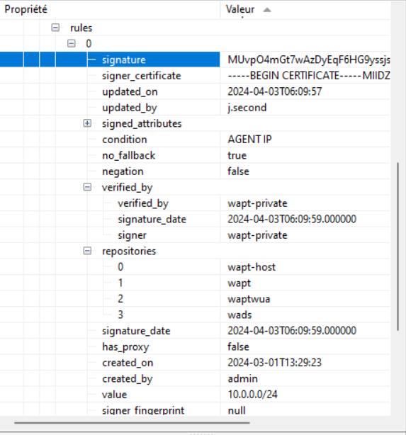

thank you for your reply.
In repo_url, I have "http://occ005907.occitanie.cci.fr/wapt"
(the rules are attached).
As soon as I remove the rule, everything works.
Thank you.

- Attachments
- 2024-04-03 08_19_49-WAPTConsole Enterprise version 2.5.4.15342.png (85.77 KB) Viewed 6494 times
