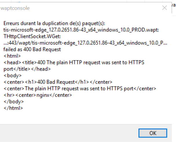

Hello everyone,
We recently upgraded our server to version 2.5 Enterprise. Everything worked after changing the TLS version to 1.2 in the Nginx configuration.
Client updates worked, as did package updates.
However, for the past few days, we haven't been able to update packages.
We get the following message:
Error duplicating packet(s): package name:THttpClientSocket.Wget:....:442/wapt/package name fails as 400 Bad Request
<html>
<head><title>400 The plain HTTP request was sent to HTTPS port</title></head>
<body>
<center><h1>400 bad Request</<h1></center>
<center>The plain HTTP request was sent to HTTPS port</center>
<hr><center>ngxinx</center>
</body>
</html>
We can't see where the problem could be coming from... a certificate issue...?

I'm joining this request.
Since today only, and not on all packages, some work fine.
I should point out that in my case, nothing has changed in the server configuration, which has been up to date for a while.

the problem was related to a misconfiguration on the Wapt store. This should now be resolved.
Have a good day
