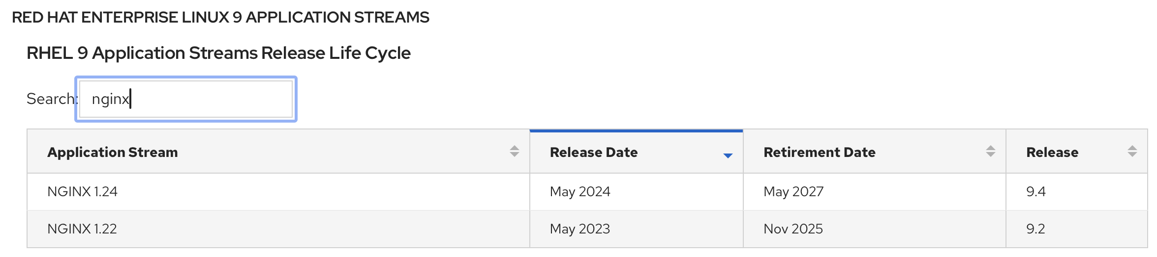

Hello Denis,
Indeed, Nginx is only officially supported in v1.22 and 1.24 under RHEL9.
Screenshot 2024-09-15 at 08:49:22.png
Screenshot 2024-09-15 at 08:49:22.png (87.35 KB) Viewed 7137 times
The only way for me to keep up with Nginx developments and fixes would therefore be to compile the module sources by hand, which clearly does not seem easy with Nginx.
Nginx v1.22 will be supported until November 2025 on RHEL9 so I assume that security patches will be supported by RedHat until then.

Hi Jean-Marc,
OK, that matches what I found on my end. :-)
We'll add the module version for nginx 1.24 to the internal build chain. That way we'll be all set until 2027!
