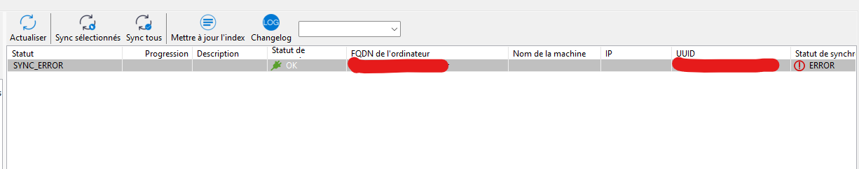

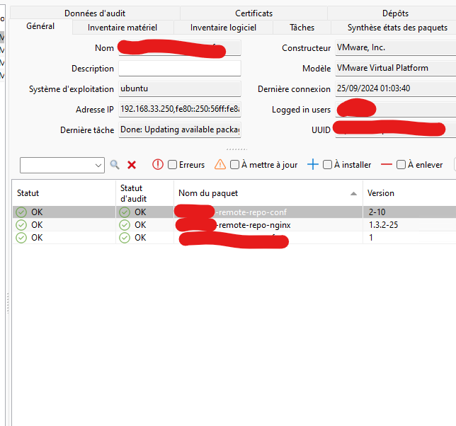

Hello everyone,
I just started creating a secondary repository on a Linux agent and I'm getting a sync error.
Regarding what has been done
Installation of the Ubuntu Linux agent version 22.04 and then addition to the WAPT server
Install the remote-repo-conf package (version 2.10) and the remote-repo-nginx package (version 1.3.2.25)
Once done, I launched the index update and then the synchronization; it progressed to 99% and then went into sync_error, and I have no further information, so I am stuck.
Could you help me troubleshoot this, or failing that, provide me with the log file under Linux so I can take a closer look (I have nothing in /var/log/waptservice.log or in /var/log/wapt-get/)?
Thanks in advance
