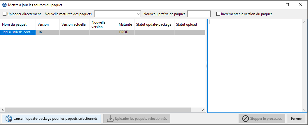

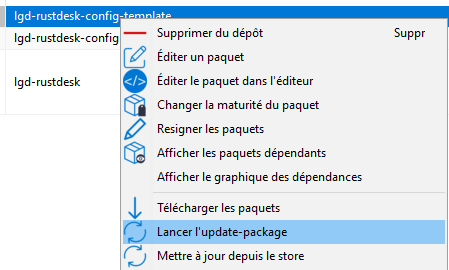

in the "Private Repository" we right-clicked on the rustdesk-config-template package and launched the "update package".
Then we selected "Run update-package for selected packages",
after answering "yes" to the first question

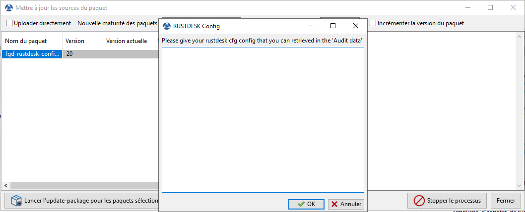

I downloaded and tried to use v20 but there seems to be a small bug:
Where can I find the "Audit data" file?
Edit: Found it, unlike the previous package, the JSON question should be answered with no

I confirm it works correctly, :) thank you.
