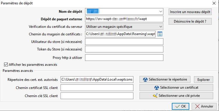

Since updating a WAPT server from version 2.4 to 2.5.5.15697, I can no longer add this server as an external repository from another server also in version 2.5.5.15697 (this worked fine in 2.4).
Repository configuration:
If we try to import a package from this repository:
I therefore assume that this has to do with the activation of SSL client authentication since 2.5, but I don't see how to authenticate the administration console of a server A via adding an external repository to a server B. The agents of the machines attached to their respective servers work correctly at the level of SSL + Kerberos client authentication.

you've correctly identified the problem. Currently, client certificate authentication isn't supported in the package import interface. I think the simplest solution is to define a second virtual host on the server without client certificate authentication but with source IP address restrictions, and point the other servers to it.
Normally, there's no need to set up multiple WAPT servers except for very large organizations with delegated access rights. If you have remote sites, the best approach is to set up secondary repositories, but centralize inventory updates on the same server.

I'll look into the VHOST solution. Otherwise, I found a "dirty" but temporary fix: I retrieved the client certificate and private key from "C:\Program Files (x86)\wapt\private" on server A and copied them to server B. I then pointed them to the repository settings under "Advanced Settings > Client SSL Certificate Path" and "Advanced Settings > Client SSL Key Path".
