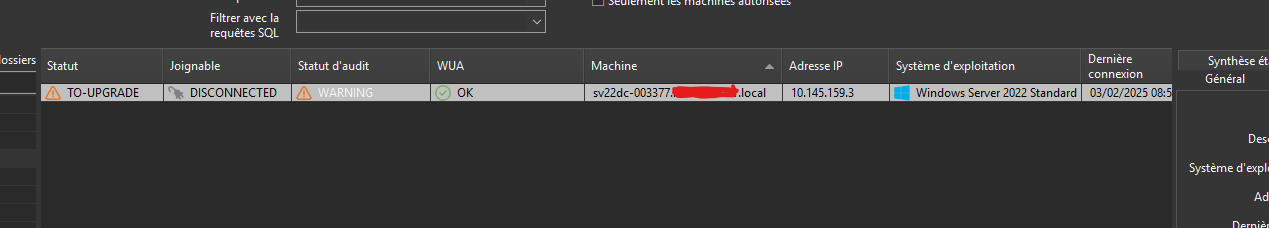

Hello everyone,
I'm having a small problem since the update to 2.6.0.16881 (it's possible the problem existed before, but it was imperceptible). Many agents are showing as disconnected immediately after installing the update. On these agents, I can run `wapt-get search` and find packages that were added after they "disconnected." However, I think this might not be a good test since it uses a remote repository, which could explain why it's finding packages.
I performed the update yesterday, and some PCs were marked as disconnected all day yesterday, but they're showing up again today.
So, my question is: how can I be sure the agent is communicating with the server (if `wapt-get search` only checks the local repository)? I tried `wapt-get register`, and it tells me the agent is correctly registered on the server, but it still appears as disconnected.

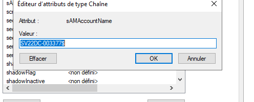

Hi Augustin,
could you please check the agent logs \log\waptservice.log for any specific errors? You should normally see lines like "INFO Creating socketio client".
In the latest version, we had a regression if there was a difference between the local name and the AD samAccountName (often due to the machine's initial name being longer than 15 characters, which is quite common on Linux). Could the machines in question be experiencing this issue?

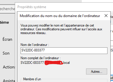

Initially, I believe I understand that it can't find a host for that name on the server (the server name hasn't changed in the meantime); it's 13 characters long if we don't count the domain name
Either I misunderstood, or he's trying to use HTTP with the server using HTTPS?
Regarding the name, in this case the samAccountName AD and the local name are the same

Hi Augustin,

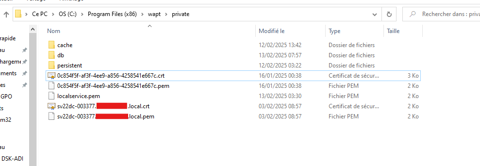

it seems the agent's client certificate is no longer accepted by the server. It's trying to re-register, but since it doesn't have a Kerberos configuration, it needs a login/password.
From which version of WAPT was the upgrade performed? The certificate in the agent's /private folder is indeed signed by the server's CA (you can double-click the .crt file to see if it's self-signed or signed by an authority).
If you register manually, does the machine reconnect correctly?

Hello Denis,

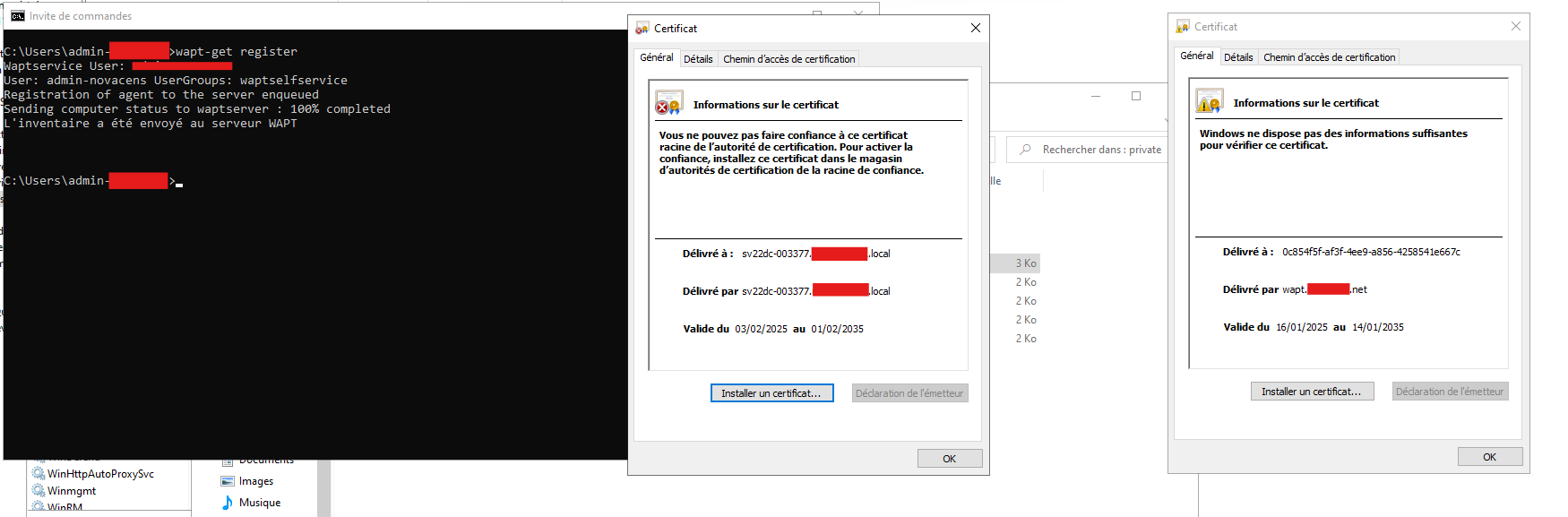

Sorry for the delay. The upgrade was performed from the previous version (I don't remember it offhand, but it was 2.6.0.16613, if I recall correctly)
I just checked, and the certificate is self-signed. Actually, I have two certificates in the folder. The one with the server name is self-signed (possibly because it was also a secondary repository at one point?), and the other, named with the server's UUID, is signed by our server.
When I run `wapt-get register` (without a password), it says the inventory was successfully sent to the server, but it doesn't update. The last time I had this issue on a machine (I didn't have time to investigate), I resolved it by completely uninstalling and reinstalling the agent.
Sincerely
