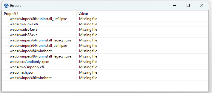

But at the end of the synchronization, the repository fails to display an error in the console, and here are the details:
Do you have any idea?
Messages: 2380
June 11, 2025 - 2:58 PM
this happens when you disable WADs on the WAPT server and enable WADs synchronization on the secondary repository.
It tries to download the WADs files but gets a 404 error because the server returns a 404 if WADs is not enabled.
The simplest solution in your case is to enable WADs in the postconf file to see if that resolves the issue.

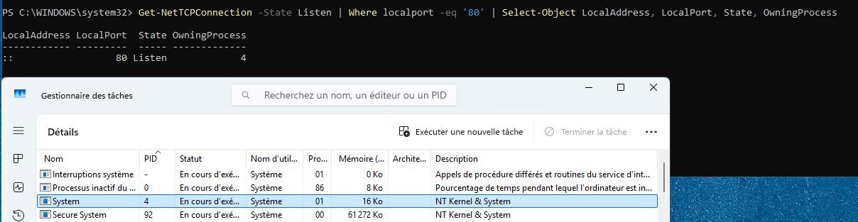

Regarding the port, you can run the following command which gives you the process associated with the port (OwningProcess column):
Code: Select all
Get-NetTCPConnection -State Listen | Where localport -eq '80'
Sincerely,

This is a System process:

sfonteneau wrote: ↑June 11, 2025 - 2:58 PM Hello
, this happens when the WADs functionality is disabled on the WAPT server side and WADs synchronization is enabled on the secondary repository side.
The simplest solution in your case is to enable WADs in the postconf to see if that resolves the issue.
I just restarted the postconf and I'm getting this error at the end :(
