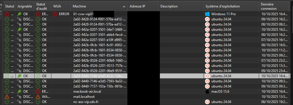

We are currently experiencing an issue with some Ubuntu 24.04 machines appearing twice in the WAPT console.
Our WAPT configuration uses the FQDN as the machine UUID (use_fqdn_as_uuid=1).
However, we observe that some posts initially appear with the correct UUID (corresponding to the machine name), then reappear with a different UUID or name.
It appears that this behavior varies depending on the network used — for example, when the machines are connected via VPN or on another network.
Do you have any suggestions or recommendations to avoid these duplicates?

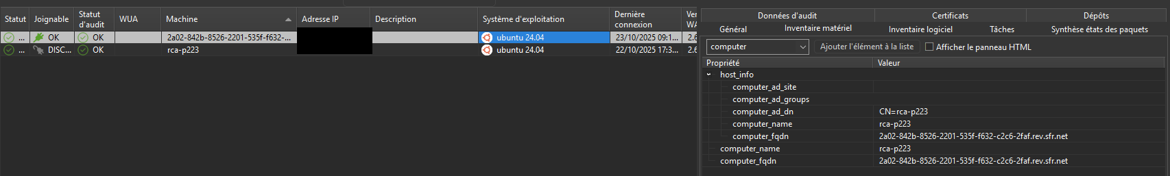

October 23, 2025 - 09:23
Our Ubuntu users are not on the domain.
Therefore, the file /etc/krb5.keytab does not exist.
The /etc/hostname file does indeed contain the machine name without the "."
On the WAPT side, the "computer_name" is correct!
Screenshot 2025-10-23 091322.png (33.72 KB) Viewed 25949 times
Screenshot 2025-10-23 091021.png (11.47 KB) Viewed 25949 times
Sincerely

Hmm
. Since there's no period (.) in the hostname and no keytab, the function performs a reverse IP address resolution to find a fully qualified domain name (FQDN). And that's where it responds (apparently the SFR box).
In the code, we should reject the proposed FQDN if it doesn't start with the hostname. This could be a solution to avoid incorrect retrieval. And therefore, no FQDN.
Otherwise, on your end, you should add a period (.) to the hostname so it becomes an FQDN (at least a name like "Hello" mycomputer.local).
