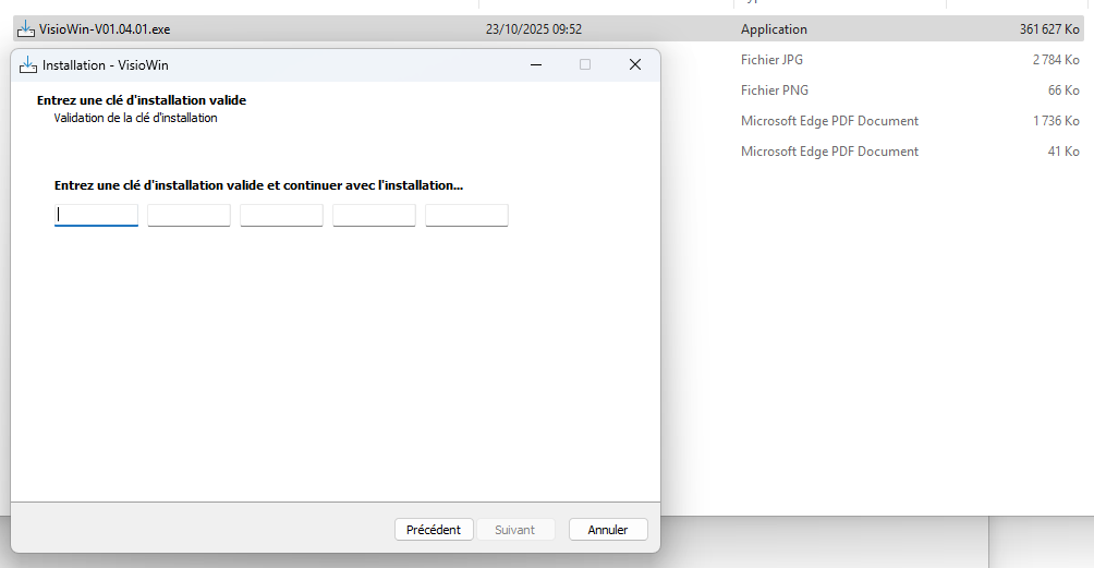

Hello everyone!
I'm a WAPT beginner and I'm trying to create a package for the VisioWin software published by FIM Medical.
The EXE file requests a valid installation key during a standard installation, but I don't know how to include it in the package for a silent installation.
This step occurs right after the license agreement, and I'm using Windows 11.
Does anyone have any ideas?
Thanks in advance for your help.

Perhaps silent flags can be displayed with this type of command line:
Code: Select all
VisioWin-V01.04.01.exe /?
Code: Select all
VisioWin-V01.04.01.exe --help
Code: Select all
VisioWin-V01.04.01.exe /help
Otherwise, you need to contact the software publisher to find out how to integrate this key during a silent installation.
