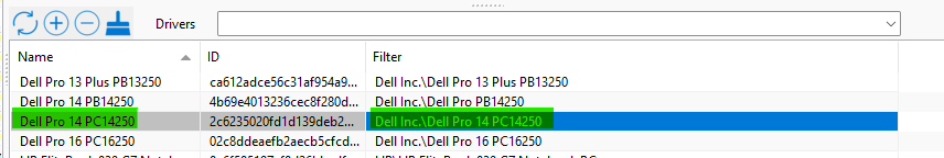

Regarding the Dell Pro 14 PC14250 workstations, the drivers are not deploying correctly during the master image process. See the attached image for details
We see the line corresponding to the driver in question: at the Filters level I indicated the return of the command: "Get-CimInstance -ClassName Win32_ComputerSystem | Select-Object Manufacturer, Model" from a Pro 14 PC14250 workstation.
I used the manufacturer's drivers: https://www.dell.com/support/kbdoc/fr-f ...windows-11
Do you have any suggestions for solving this problem?

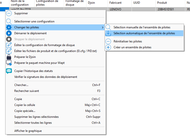

I think I understand; there's some confusion.
The filter you mentioned is meant to be used as shown in the image.
Is that what you're doing before deployment?
After clicking the button, the "driver configuration" column should be populated.

Technically, when you click on "Automatic Driver Bundle Selection," the console takes the "Manufacturer" and "Product" columns from the grid.
Then, the console retrieves all existing driver bundles and checks their filters. If it matches MANUFACTURER\PRODUCT, then the driver bundle is assigned.
Therefore, for this to work, the PC's "Manufacturer" and "Product" columns must be populated, and the filter must match.
You can verify if the filter matches by checking that, after clicking "Automatic Driver Bundle Selection," the "Driver Configuration" column is populated with the correct bundle.
