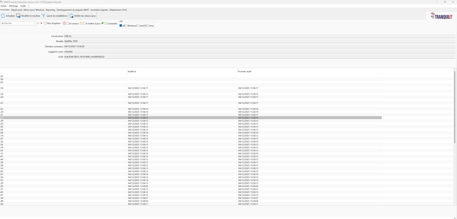

On a related note, I don't know if it's connected, but since this version, the display resets every time the console is reopened; that is, all the windows and columns are resized in a way that's not very visually appealing. If you have any tips for that too...

Like this?

There is indeed a major bug with saving/reloading the grid and panel layout when not at 96dpi.
The design is created at 96dpi, and when the application loads, all elements are scaled if the screen is not at 96dpi.
The problem with saving the layout is that it saves a layout that is already scaled.
When it is reloaded in the next session, the scaling is reapplied to a layout already at the correct high dpi, so everything shifts exponentially.
Therefore, we need to save the layout upon exiting the application (file %APPDATA%/waptconsole/waptconsole.ini) by applying inverse scaling to return to 96dpi.
