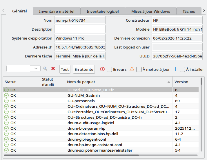

We just upgraded to version 2.6.1.17654 on our production server and I've noticed a bug when deploying a machine via WADS and installing packages through its OU. A number of packages are not showing up for audits in the General tab.
Even using the "Run all package audits" function, these packages remain with an empty audit status (I've tested this multiple times, rebooting and refreshing the machine inventory).
However, if we manually select each package in the General tab with an empty audit status, right-click, and choose "Run package audit" for that group, then the package audits are displayed correctly.
It seems that the "Run all package audits" and "Run package audit" buttons have different functions and therefore produce different results.

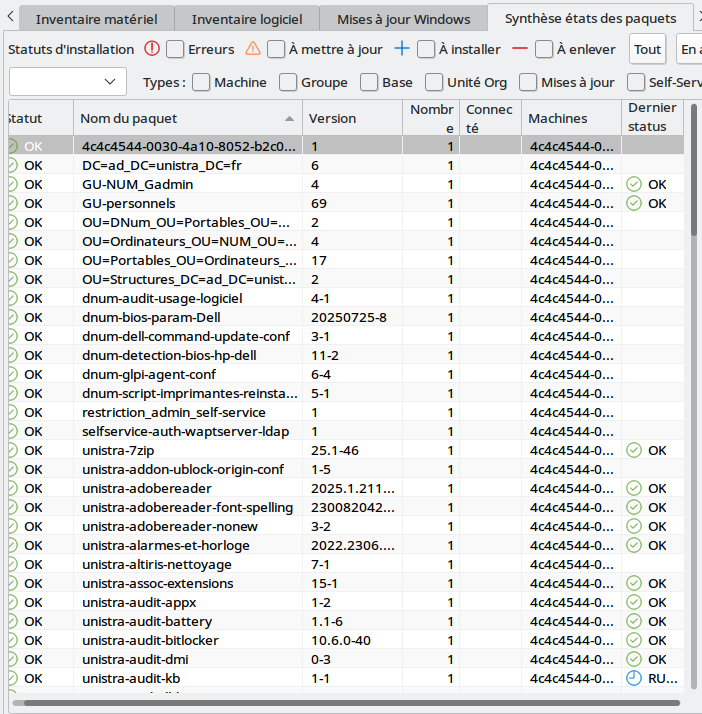

Despite this, we've noticed that quite a few of our packages are having trouble automatically submitting their audit trail in version 2.6.1.17654.

After manually forcing each package to be audited and passing them to OK, I reinstalled the machine and the problem is still the same after the fresh installation:
However, the issue does not seem to be present on your latest release released Wednesday evening (2.6.1.17705).
