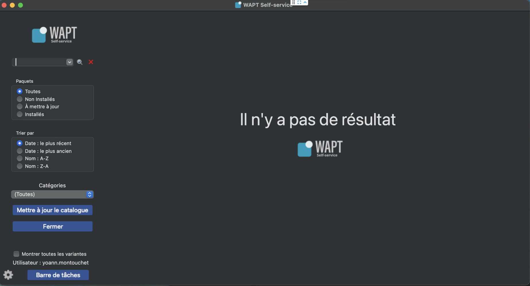

Hello everyone,
I'm sorry to bother you with a problem that seems so trivial to me, but I'm tearing my hair out over the configuration of a wapt agent on macos 26.3.
The workstation is newly installed, connection to the domain is OK and VPN is set up.
We can clearly see the post in the wapt console, we can push packages from there without any problems.
You can also view the packages available on the server via "wapt-get search", and install them without any problems.
However, the self-service feature is not working. It consistently displays "No results found":
Screenshot 2026-03-02 130303.png (222.37 KB) Viewed 10836 times
I know we managed to configure another Mac previously, and it's still working today. But I can't figure out what's missing on this one... Is there a log somewhere we could use?

We're definitely on "wapt enterprise", version 2.6.1.17705, the Mac is in the correct OU, there's a "self-service" package that I installed manually without any changes... help!!! 😅

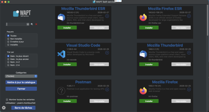

But this will be quick: I tried changing the log level to debug. Then I restarted the wapt service, and after that, I don't understand I can now see the content displayed...
Screenshot 2026-03-02 132241 (Small).png (155.2 KB) Viewed 10819 times
In terms of actions taken today, I only see two things: installing the self-service package and then restarting the wapt service. Could these two elements explain why it's working now? 🫣
Otherwise, I don't understand...
EDIT: Okay, that's it, it was adding the self-service package that unlocked it, potentially followed by restarting the service... I'll make a note of it in my documentation!

Yes, it's still working. I can confirm that the missing self-service package was the issue. I don't know why adding it earlier didn't get everything working, but it's fine now.
Removing the package leaves the self-service area empty, and adding it back restores its contents.

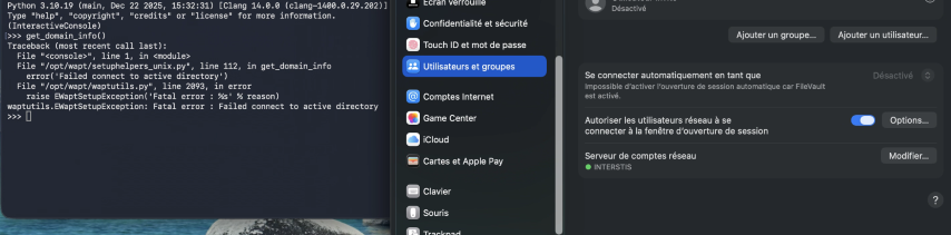

Another question, which might be normal, is that self-service is supposed to be installed for all machines in an OU, but I see that the Mac is only visible in the "(All)" group; it disappears as soon as I look at an OU in the directory tree.
Is this "normal" for Macs? Windows machines appear correctly in the appropriate OU, but not the Macs.
EDIT: Correction, only *this* Mac doesn't appear in the correct OU; the other Macs are fine (and self-service installed itself for them).

You can try watching on the Mac:
Code: Select all
wapt-get shell
>>> get_domain_info()
yoann.montouchet
Messages: 35
Registration: January 10, 2025 - 6:32 PM
March 2, 2026 - 2:57 PM
That's strange, it seems he can't connect to AD even though it's reachable, and I was able to add an AD user on my end:
Screenshot 2026-03-02 145457 (Small).png (131.96 KB) Viewed 10777 times
I'm going to try rebooting and starting over
EDIT: It's the same after rebooting, with the VPN connected and even after restarting the service. Self-service works, but Active Directory seems unreachable

yoann.montouchet
Messages: 35
March 2, 2026 - 4:26 PM
I just pulled up another Mac that appears correctly in the OU, but we're getting the same message as the Mac that's giving us trouble today. Could it be related to our infrastructure? We're on a Samba-AD server at the AD level, but it's only accessible through a VPN.
