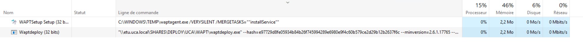

March 19, 2026 - 10:13
And FYI, disabling the antivirus doesn't fix the problem
These two processes are still blocked:
Screenshot 2026-03-19 100913.jpg (51.8 KB) Viewed 21029 times

Actually, my colleague created a support ticket for this issue (https://espaceclient.tranquil.it/support/2601197)! ;)
For the time being, we've worked around the problem by reverting to the old agent (version 2.6.1.17472), and it's working.
