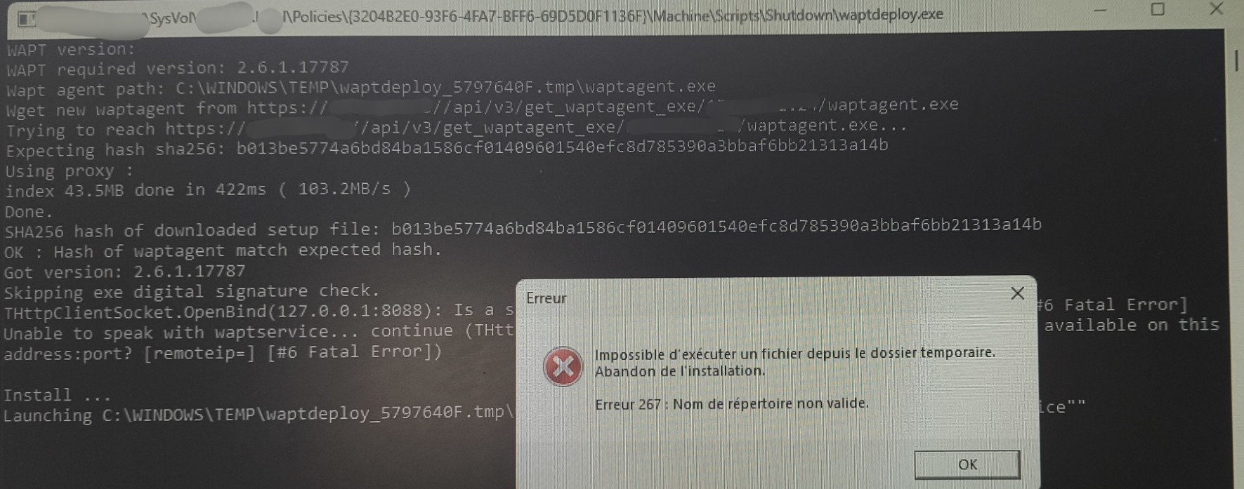

Hello, we want to deploy using the GPO method with a startup script, Waptdeploy, as in the following tutorial: https://www.wapt.fr/fr/doc-2.6/wapt-deploy-agent.html
. We also added a GPO for shutdown in addition to startup.
However, an error occurs on the target computer.
We have already tried uninstalling the antivirus, but without success.
Would any of you have a solution to our problem, please?

Hi Benoit,
we've already received feedback about this issue without really finding the cause of the problem for Windows... indeed, the error message doesn't correspond to the actual problem.
Could you try the workaround we mentioned in the thread en/viewtopic.php?p=17118#p17118?
Regards,
