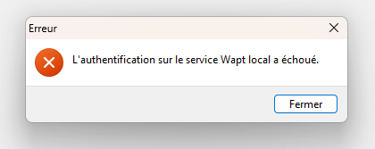

Since the version upgrade, with the same configuration (waptserver-ldap and without kerberos), we are getting the following error on Windows machines:

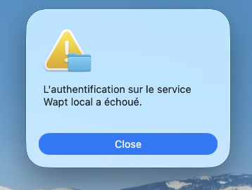

on Macs:

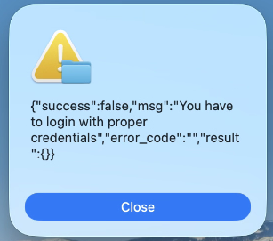

By keeping waptserver-ldap and enabling Kerberos, there are no more errors on the Windows side, but no packages are visible.
And an error on the Mac side:
Screenshot 2026-10-08 150436.png (48.22 KB) Viewed 7408 times
We tried other combinations (system, waptagent-ldap) without success and the only one that seems to restore the Windows side would be to put it in filetoken, there we find the expected content in the self-service, but on the mac we continue to see nothing, as in last March I think.

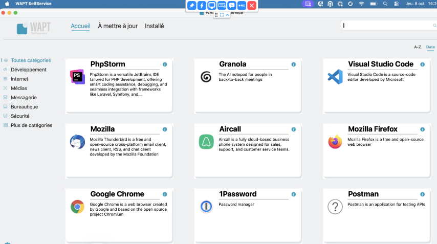

I've made some progress; you need to use the name Kerberos in capital letters: yoann.montouchet@AD.XXX.FR at the kinit level, and use a temporary file to store the token, and export the path to the token:
kinit -c FILE:/tmp/krb5cc_$(id -u) yoann.montouchet@AD.XXX.FR
export KRB5CCNAME=FILE:/tmp/krb5cc_$(id -u)
then launch manually in the same terminal:
/Applications/WAPT/WAPT\ Self-service.app/Contents/MacOS/waptself
At that point, the self-service area opened correctly with the expected packages. But there was no button to manage the packages!
Screenshot 2026-10-08 162907 (Small).png (143.38 KB) Viewed 7329 times
Clearly, it's going to be extremely difficult to industrialize these steps for colleagues... Do you have a cleaner idea, please?

regarding the display bug in the self-service interface, we've reproduced it and it's being fixed (the issue is a difference in behavior between Intel and ARM Macs).

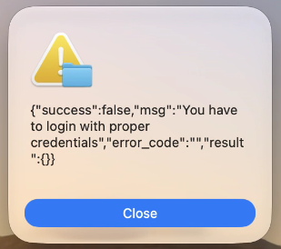

I saw this morning that a new version (2.7.0.19633) has been released. I haven't seen a changelog yet, but I've noticed that Mac authentication (without using a manually generated Kerberos token) is still broken
Screenshot 2026-10-22 121415.png (63.71 KB) Viewed 717 times
I had to roll back the self-service package configuration; I had modified the group names to put a kind of UPN (by adding @ad.xxx.fr to each group). This was necessary on the previous version, but after the switch to 19633 I no longer saw any packages on the machines.
By removing this from the groups and redeploying the new self-service package on the machines, I can see the packages again, and I can see the install/update/uninstall buttons on the Macs with Apple Silicon processors!
I made an "app" with Automator to generate a Kerberos ticket for the user, then launch the real self-service on the Macs using the generated token; it seems to work pretty well, I will probably deploy this initially on our fleet.
