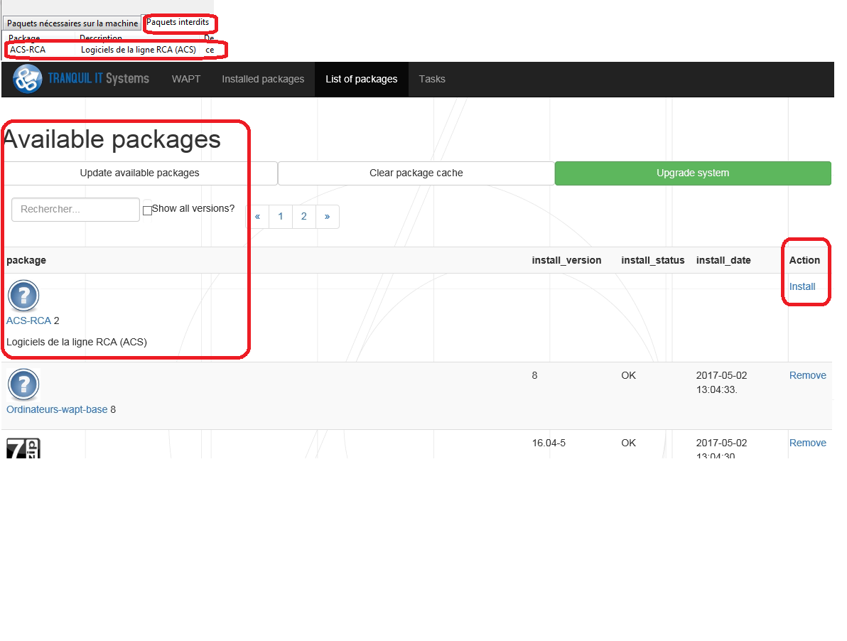

Obviously, we're starting to ask ourselves some practical questions:
  1. How can I hide a package or group of packages in the local web console (accessible via "Right-click > Show Software Status" on the system tray) so that the user only sees what they are authorized to see? I tried putting a group of packages in "Forbidden Packages" on a machine, but it still appears in the web console

Forbidden packet corresponds to the conflict field:
https://www.wapt.fr/fr/doc/Utilisation/ ... es-paquets
https://www.wapt.fr/fr/doc/CreationPaqu ... er-control
The function you are looking for is available by modifying the `section` field to `restricted` in the `control` file:
https://www.wapt.fr/fr/doc/changelog.ht ... ricted#id3
Warning! The user will still be able to install packages via the command line!
We have a more advanced feature in the works.
