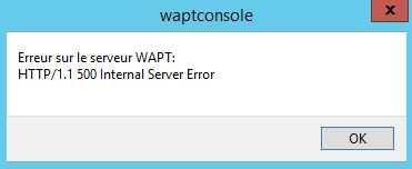

Here's my mistake when launching wapt console
I'm on the right track: the Waptapache service is paused but it's impossible to restart it

need a little help? Linux or Windows?
Otherwise, you can check the Apache logs for more information:
https://www.wapt.fr/en/doc/Frequent-pro ... la-console

Thank you for your reply.
I'm using Windows, and this is a problem because I just installed IIS on my server. I'd like to know how to remove port 80 from WAPT so I only use port 8080 and can leave port 80 for IIS.

Alternatively, you could disable the reverse proxy function so that WAPT only listens on port 8080, leaving ports 80 and 443 for IIS

Alternatively, configure Apache not to listen on port 80

I've already tried the configuration with IIS, but I simply want to stop listening on port 80. How can I do that?

The Apache configuration file is located here: c:\wapt\waptserver\apache-win32\conf\httpd/conf Apache documentation : https://httpd.apache.org/docs/2.2/fr/bind.html

Thank you, I managed to change the ports. Now, when deploying via GPO, waptdeploy looks for wapt.domain.local and not serveur.domain.local. How do I fix this?
