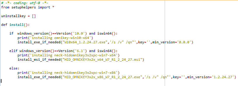

I'm having trouble with Python when installing proprietary software. It's a specific type of software, with installers of different types (sometimes .exe, sometimes .msi) that also vary depending on the operating system. I want to use the `iswin64()` and `windows_version()` functions to identify which installer to use during deployment. My problem is this: it doesn't seem to identify the specific OS version and always chooses the installer for the Windows 7 x86 version (which is what happens in my "else" statement).
The problem seems to be coming from windows_version(), having already used iswin64() without any problems before.
Could you shed some light on the problem?
Thank you in advance for your answers.

Your code looks correct.
You can add:
Code: Select all
print windows_version()
to check the version of the device.

Thank you, the "print" command did indeed point me in the right direction: I was able to see that my Windows 10 version was actually exactly 10.0.14393.
As you said, the "==" was therefore irrelevant. So I modified the first part, using ">=" for 10.0 for Win 10 and ">=" for Win7 x64 for ".
It works perfectly, thanks again for the help, problem solved ;)

To complete the process,
you need to add the program's uninstall key to the `key` argument of `install_exe_if_needed`. It's currently empty :shock: !
To retrieve the key:
https://www.wapt.fr/fr/doc/CreationPaqu ... stallation
Then add it as an argument to the `install_exe_if_needed` function
: https://www.wapt.fr/fr/doc/CreationPaqu ... -if-needed
