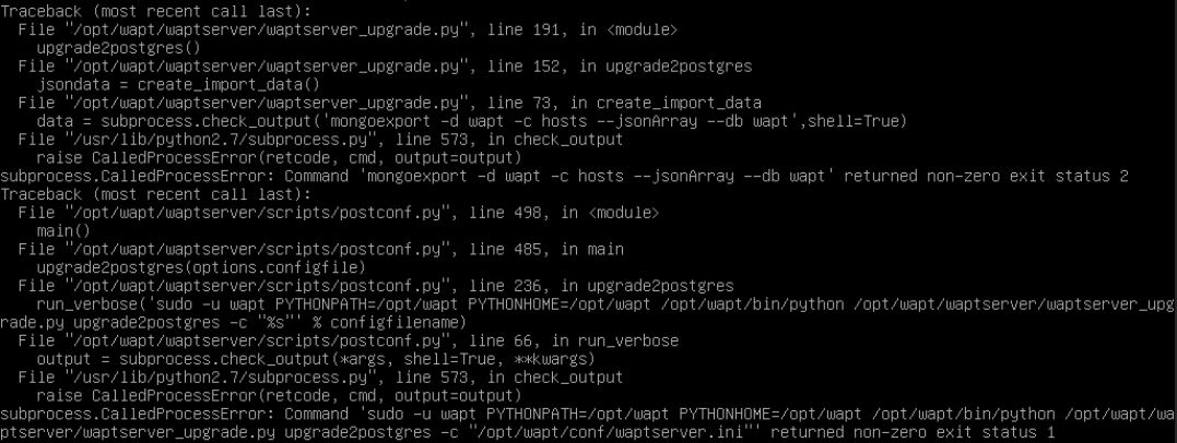

I've tried unsuccessfully so far to migrate from 1.3.13 to 1.5.
My server is running Debian Jessie 64-bit, and everything goes smoothly until the postconf script is launched. (I chose option 1, no Kerberos security.)
At the step where I confirm the MongoDB to PostgreSQL migration request, the script crashes (see attached image).
Any ideas?

This is a known bug.
Could you please try again with version 1.5.1.22?

yes, with the update, I was able to complete the procedure.
