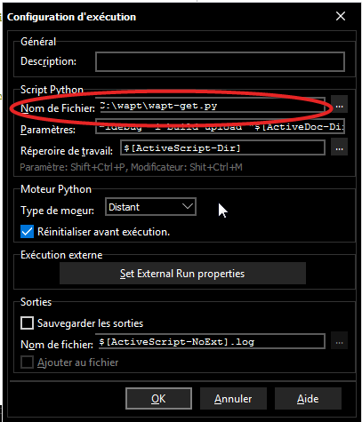

Following the upgrade to version 1.5 on my workstation where the console is installed, I have the following problem with pyscripter.
The execution configuration, for example, for the function "-i build upload" stay on c:\wapt\wapt-get.py
I've tried changing the route C:\Program Files (x86)\wapt The next package edit will revert to the old path
Does anyone have any idea?
I looked through all the PyScript settings

Yes, it is indeed a regression:
https://roundup.tranquil.it/wapt/issue945
Hi !admin-style wrote: ↑Apr 10, 2018 - 8:10 AM Hello,
Following the upgrade to version 1.5 on my workstation where the console is installed, I have the following problem with PyScripter.
The execution configuration, for example, for the "-i build upload" , remains at c:\wapt\wapt-get.py
PB WAPT.png.
Even though I change the path to C:\Program Files (x86)\wapt, the old path reappears after the next package edit.
Does anyone have any ideas?
I've looked through all the PyScripter settings.
I had the same problem, which I easily solved by copying and pasting the contents of C:\Program Files (x86)\wapt into c:\wapt
