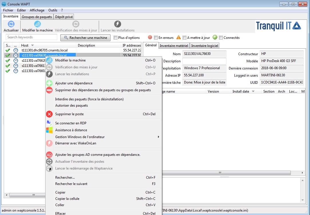

June 7, 2018 - 12:53
In the WAPT console, "Checking for updates" and "Launch installations" are greyed out.
Where could this be coming from?
