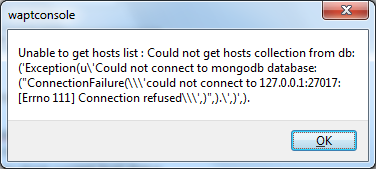

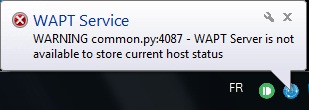

I migrated my WAPT server from a laptop to a virtualization server and for the past few days I have been encountering errors.
2015-05-12 08:44:02,816 WARNING WAPT Server is not available to store current host status
2015-05-12 10:41:55,369 WARNING WAPT Server is not available to store current host status
2015-05-12 12:41:49,615 WARNING WAPT Server is not available to store current host status
2015-05-12 14:42:00,494 WARNING WAPT Server is not available to store current host status
2015-05-12 22:42:26,180 WARNING WAPT Server is not available to store current host status
2015-05-13 09:05:00,022 WARNING WAPT Server is not available to store current host status
and the following messages since this morning
The server appears to be working:
C:\Users\administrator>ping wapt
Sending a 'ping' request to debian.lyc-prieur.loc [10.121.86.15] with 32 bytes of data:
Reply from 10.121.86.15: bytes=32 time
Ping statistics for 10.121.86.15:
Packets: sent = 4, received = 4, lost = 0 (0% loss),
Approximate round-trip times in milliseconds:
Minimum = 0ms, Maximum = 0ms, Average = 0ms
Thanks in advance.
