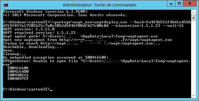

When I run the new script, this is the message I get.
Whether the old server is on or off, it gives the same result.
It detects the presence of the old version and therefore cannot complete the installation of the new one. For the moment, I am forced to uninstall the old agent manually.
Messages: 2380
July 9, 2018 - 3:09 PM
It can't open c:\users\nfdkjfznkjfznk\AppData\Local\Temp\waptagent.exe.
Antivirus?
Accent in the username hidden?
File already open or incorrect permissions?
SRP enabled?
