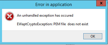

Hello everyone,
We have recently started using WAPT and, following a deployment on a few workstations, we are encountering the following error:
Code: Select all
ERROR IN APPLICATION
An unhandeld exception has occured
EWaptCryptoException: PEM file does not exist
We searched for the public key in the UUID.wapt file corresponding to the machine in question and this file does not appear anywhere on the server.
It appears that the key was not retrieved correctly. However, this does not explain how the device still appears in the console.
We have already tried removing the machine from the console and uninstalling the agent on the machine in question, but the automatic reinstallation of the agent by the GPO that we put in place did not solve the problem.
Do you have any suggestions for bypassing this blockage from the console, directly on the server, or on the workstation?

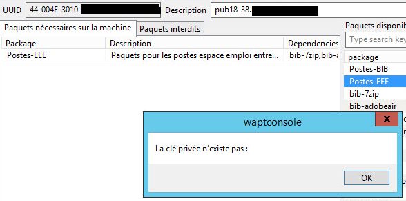

1) I didn't see this error in a log file. This error occurs when I'm in the administration console and I try to add a dependency. See attachments "error 1" and "error 2".

Error 1 occurs when I right-click on the host => add a dependency (in my case, a package group) => OK.
Error 2 occurs when I edit the machine => select packages => add dependencies to the package => save and apply.
I think that, based on these two errors, there's a key exchange problem between the host and the server, which prevents authentication and therefore the application of operations from the WAPT management console.
