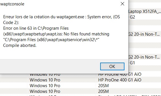

I'm experiencing the same problem after updating to version 1.8 (see attached image).
Has anyone found a solution since?
Thanks.
Thanks.

I'm replying to myself.
Actually, my ESET antivirus was deleting a file essential to the agent's construction; I disabled it and it's perfect!
