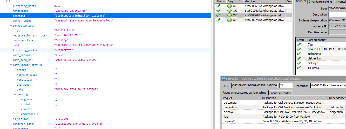

On my website (on the pc.php page) I use the API to display the packages installed or not installed on a machine (/api/v1/hosts)
However, I'm encountering a problem; sometimes the API doesn't update, as in this case:
So after 25 minutes the API still hasn't changed and displays 3 dependent packages while the machine has 5.
There you go.
Have a good rest of the day
- JEANTET Joey, development student
Messages: 2380
June 11, 2019 - 5:08 PM
When you create a machine package, it is up to you to populate the dependency table
