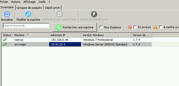

I'm installing a brand new WAPT server. I was able to add a PC and it appears correctly in the inventory.
However, I can't force the installation from the server console: the buttons are inactive.

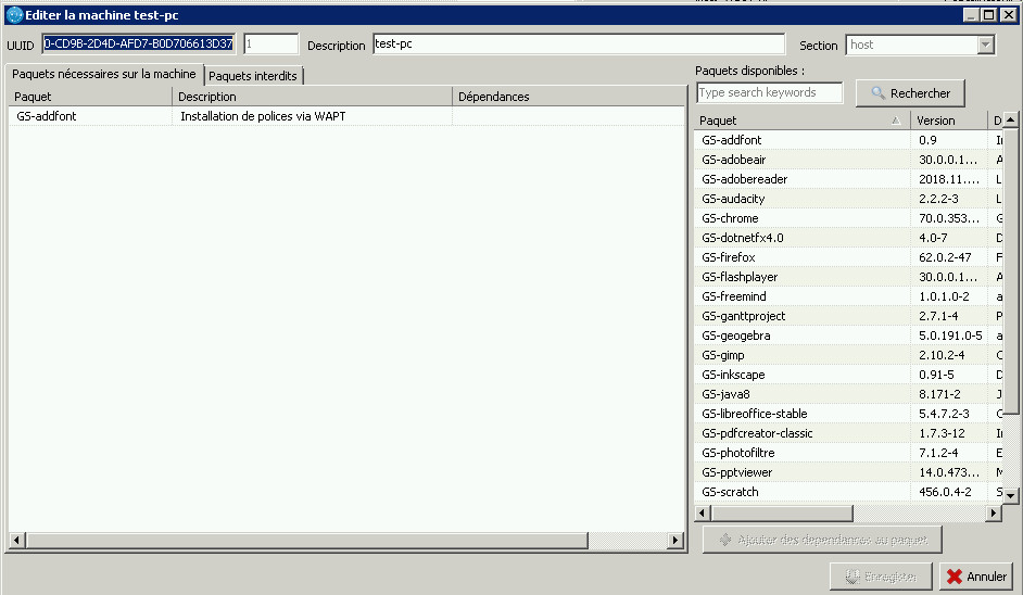

And in each machine's configuration, the "Save and apply configuration" button doesn't appear.

I'm replying to myself... problem solved it seems.
I renamed the directories C:\Users\Username\AppData\Local\Waptconsole and C:\Users\Username\AppData\Roaming\waptconsole.
Then I restarted the console and reassigned the certificate to it.
- WAPT Expert
- Messages: 2027
Hello Joel.montelimard,
Sincerely,
For your information, if the action button is greyed out, it means that the signing key configured in the console does not match the certificate that is installed on the machine.joel.montelimard wrote: ↑June 24, 2019 - 9:41 AM I'm replying to myself... problem solved it seems.
I renamed the directories C:\Users\Utilisateur\AppData\Local\Waptconsole and C:\Users\Utilisateur\AppData\Roaming\waptconsole.
Sincerely,
