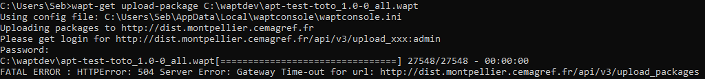

I have a problem following the update of a WAPT server from version 1.3.13 to version 1.7.4.
Everything is working fine: package deployment, adding new hosts, etc...Except for uploading or deleting packages
When uploading packages, I get the following error message:
HTTPError: 504 Server Error: Gateway Time-out for url: http://dist.montpellier.cemagref.fr/api ... d_packages
After the transfer, this message appears after about thirty seconds (during which the console is unresponsive) regardless of the upload method:
-via waptconsole to import a local package
-via waptconsole to import a package from the tranquil.it repository
-via the command prompt with wapt-get build-upload or upload-package
The following message appears simultaneously in the nginx error.log file on the server:
[error] 1890#1890: *2186 upstream timed out (110: Connection timed out) while reading response header from upstream, client: 172.16.10.78, server: dist.montpellier.cemagref.fr, request: "POST /api/v3/upload_packages HTTP/1.1", upstream: "http://127.0.0.1:8080/api/v3/upload_packages", host: "dist.montpellier.cemagref.fr"

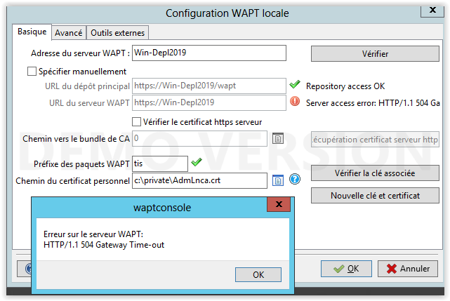

I have the same problem after installing Wapt 1.7.4.6165 on a Windows Server 2012.
To give you some background, I had a Wapt 1.5.21 system on another Windows Server 2012 that worked perfectly until it crashed. I had to rebuild another Server 2012 on different hardware, but with the new version of Wapt.
The installation goes smoothly until I try to connect using the console.
I get the error " Error on Wapt HTTP 1.1 Server
504 Gateway Timeout".
I should also mention that I tried reinstalling version 1.5.21 and I also had a connection problem with the Wapt console (same error). So, I might as well use the latest release.
Thank you in advance for your solutions, as I use it extensively to deploy applications in my lab.
Patrick
Patrick
