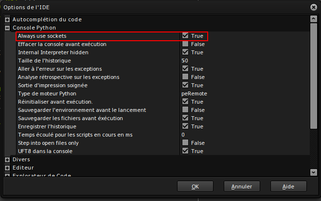

Can you confirm this setting?
Screenshot from 2019-11-25 23-17-07.png (44.57 KB) Viewed 3795 times

The " always use socket" option wasn't enabled. I just did it. I'll keep you posted. Thanks!
