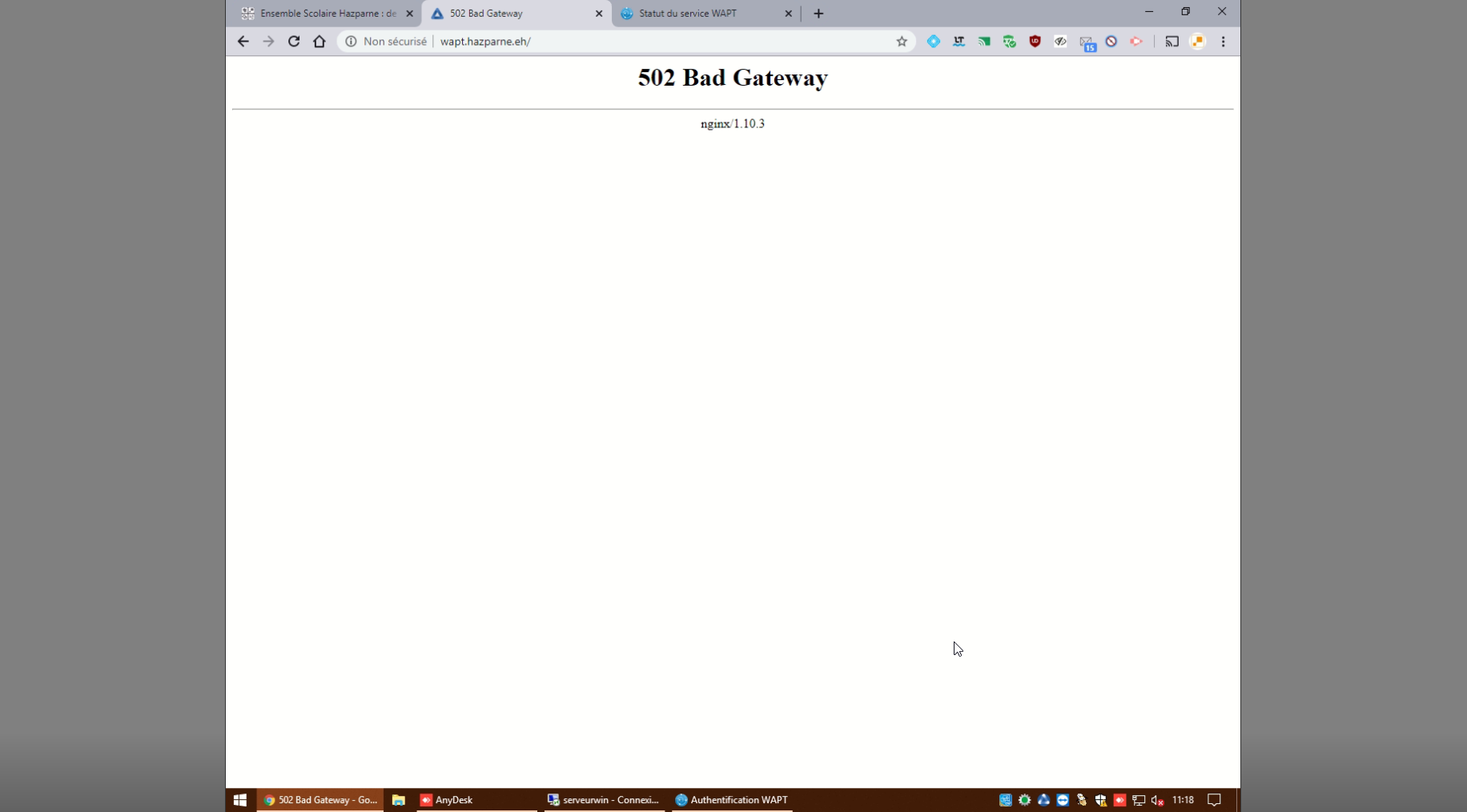

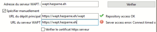

However, after a while, the connection to the server is intermittent, failing to connect
via either the console or the web interface.
Access to the repository is fine.
If I restart the virtual machine, it works again.

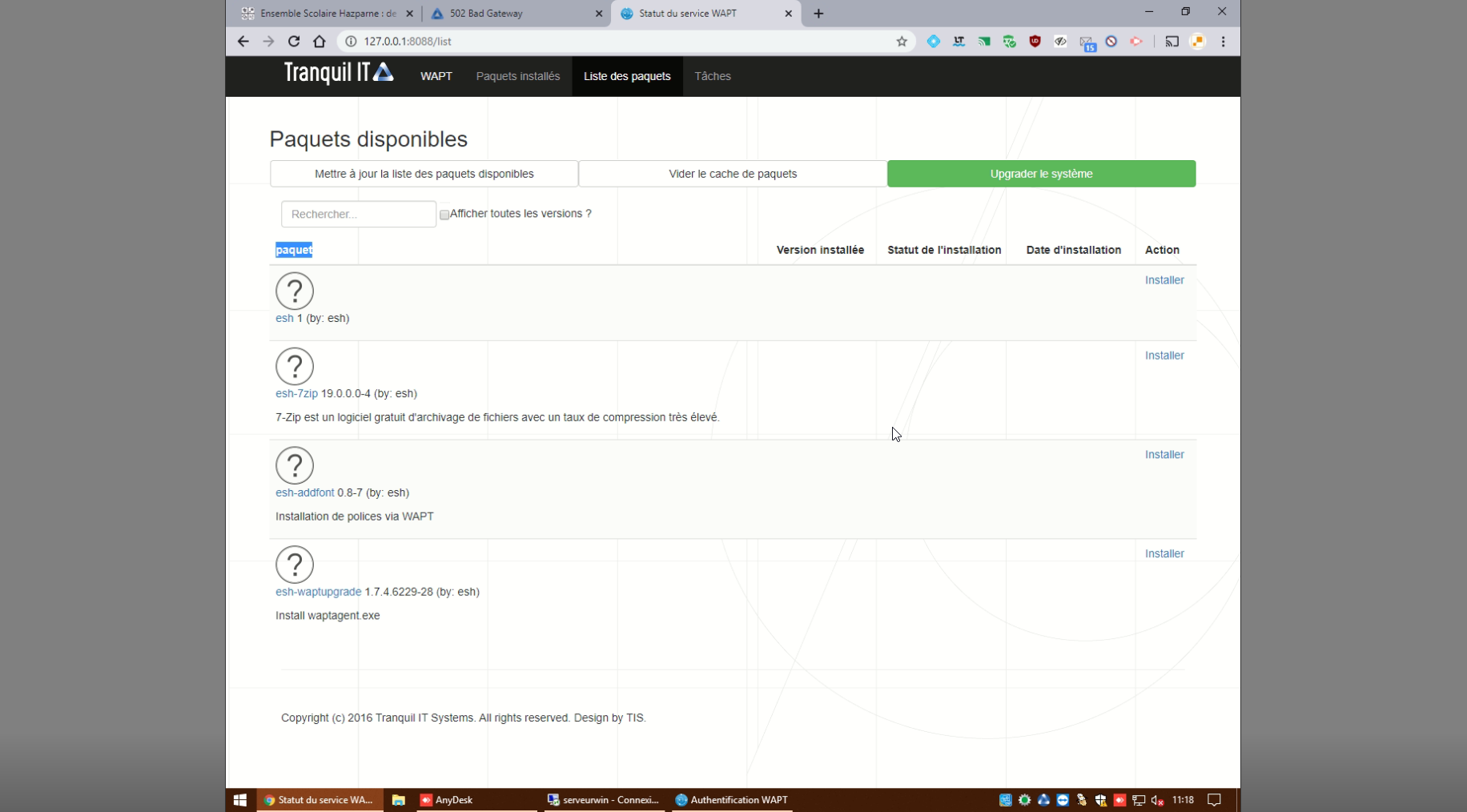

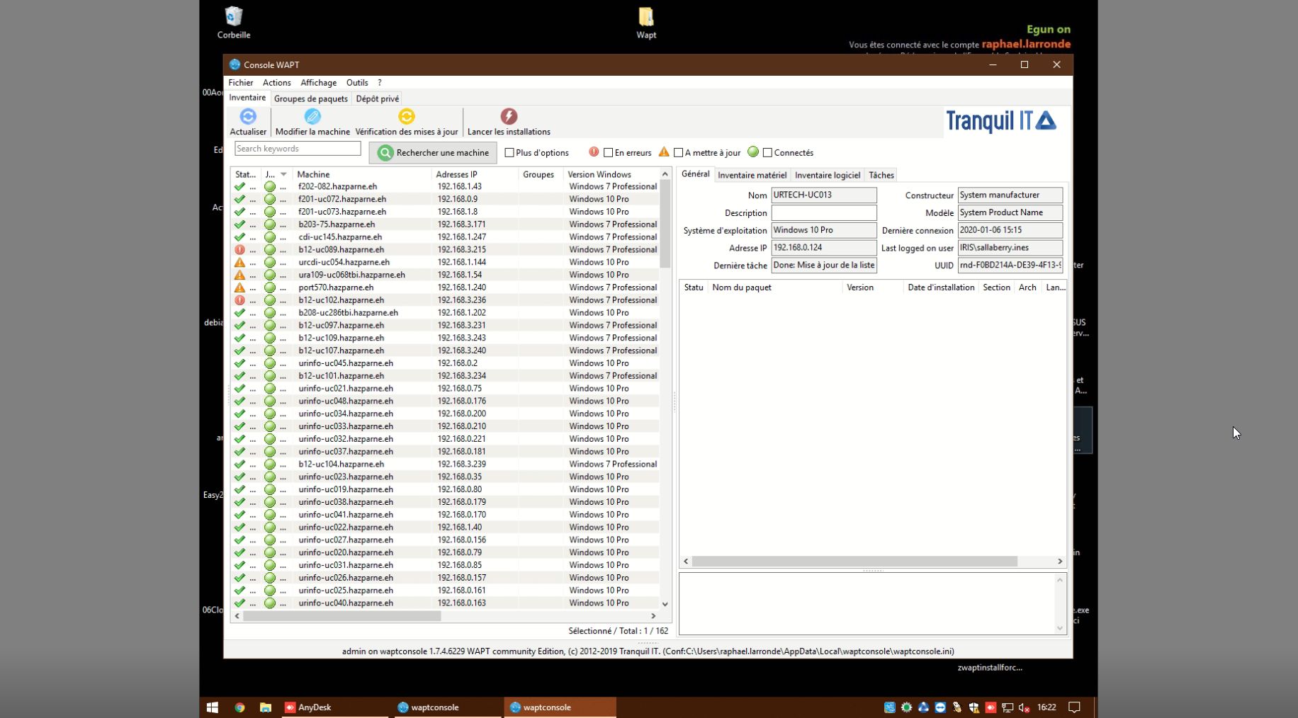

I've attached screenshots.

[SOLVED] Nginx “Bad Gateway” error

Since this morning, and despite everyone returning to work and numerous connections, it's working.
160 jobs were reported today (I emptied the database on the server).
