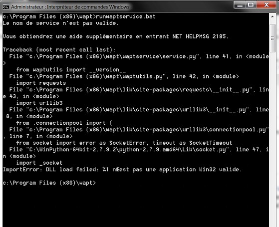

The Wapt service is not running
If I manually launch c:\program files (x86)\waptrunwaptservice.bat I get a message in the attached file.
"ImportError: Dll load failed"
I tried installing the VC redistributable: it didn't do anything
I tried installing Python 2.7.9 in 64-bit (to get the path I was looking for in the error). The file was there but nothing happened.

WAPT integrates its own Python 2.7 32-bit environment. Regarding the error message, the socket.py file retrieved by the runwaptagent.bat script is incorrect. There's likely an environment variable with a PYTHONPATH or something similar. The WAPTagent service is more careful to protect its PATH, so the error message you displayed in cmd.exe isn't necessarily the same as the one that appears in production. However, if the WAPT service is being interfered with by another Python installation, that's not normal.
Could you uninstall the Python installation(s) outside of WAPT and rerun the runwaptservice.bat script to see if you get a different error message? Do you have any entries in the service logs (usually located in c:\program files (x86)\wapt\log)? Logging has been significantly improved in the latest WAPT version 1.8.1.
