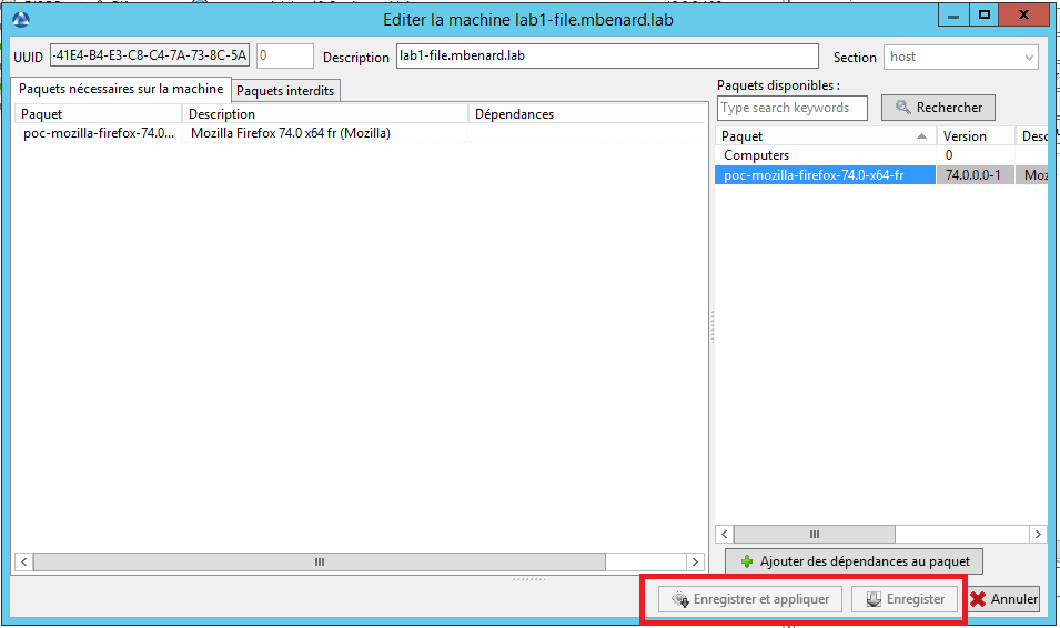

I have just installed a Wapt server to test the solution.
Version: 1.8.1.6742
Server: Windows Server 2012 R2

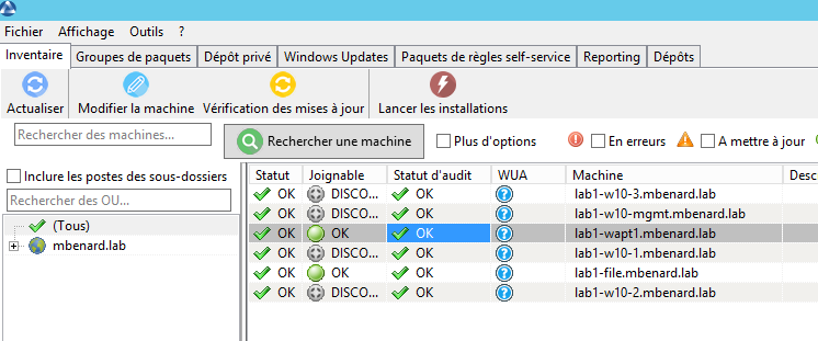

My test client is deployed and appears in the inventory. (deployment via GPO)

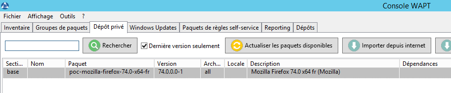

I added a package to the local repository. (firefox)
However, I am unable to apply the package to the client; the Save button is greyed out. No error message is displayed.
What triggers the activation of this button?
Thanks in advance,
Editing a machine: Save button greyed out
- WAPT Expert
- Messages: 2380
Hello.
The button only activates if you have a certificate entered in the console:
Tools -> Preferences -> Personal Certificate Path.
This same certificate must also be recognized by the machine (the certificate must be located in C:\Program Files (x86)\wapt\ssl) on the agents.
If this is not the case, add it and then restart the WAPT agent.
Are you using a CA?
If so, it's your key OR the CA.
Are you using a CA?
