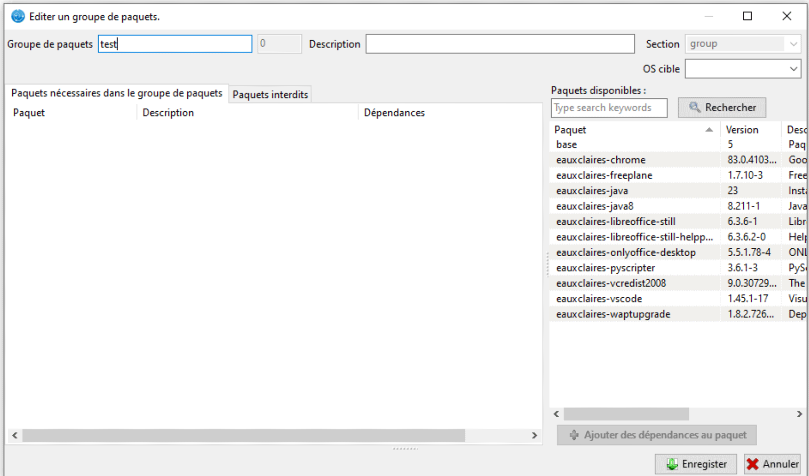

I followed your advice and the documentation.
There were no problems configuring the
wapt-get search and wapt-get install clients; they work well, and
the console is also configured
. However, I can't create a package group that has dependencies on the TIS repository. Can a package group only depend on the private repository?

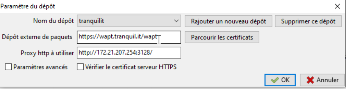

So I modified the files as described in the documentation. I thought there was an error in the documentation and that I needed to modify
%appdata%\local\waptconsole\waptconsole.ini,
so I added the private and tranquilit sections. But they then appear in the console as external repositories that I can import by re-signing the packages, which is what I want to avoid. Just to be
sure, I created a %appdata%..\localwaptconsole\waptconsole.ini with just the two fields (but I wasn't too sure it would work), but I still have
the same problem.
The TIS repository only appears as an external repository from which I can import packages to re-sign them.
the same problem.

So I have the Tranquility repository configured, and it also appears in the external repositories
But if I try to create a new package group or dependency, no tis package appears
If I'm using a wapt-get client, I can install a tis package without any problem, but at the console level, they are only accessible for import
I suspect an error in the conf file, but where?
Thank you again for all your answers
